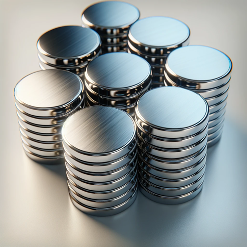

Magnet Sizes and Their Uses
Magnet Size (Imperial) Magnet Size (Metric) Uses
1/16" x 1/32" 1.6mm x 0.8mm
  • Infantry Weapon Swaps
  • Light Accessories
3/32" x 1/16" 2.4mm x 1.6mm
  • Infantry Heads
  • Lightweight Plastic Components
1/8" x 1/16" 3.2mm x 1.6mm
  • Small Vehicle Parts
  • Larger Infantry Parts
3/16" x 1/16" 4.8mm x 1.6mm
  • Medium Vehicle Parts
  • Heavy Infantry Weapons
1/4" x 1/16" 6.4mm x 1.6mm
  • Larger Vehicle Components
  • Monster and Large Model Parts
3/8" x 1/16" 9.5mm x 1.6mm
  • Heavy Vehicles
  • Large Monster Parts
1/2" x 1/16" 12.7mm x 1.6mm
  • Super-heavy Vehicles
  • Massive Models
3/16" x 3/32" 4.8mm x 2.4mm
  • Small to Medium Bases
1/4" x 3/32" 6.4mm x 2.4mm
  • Medium to Large Bases
3/8" x 3/32" 9.5mm x 2.4mm
  • Large Bases
